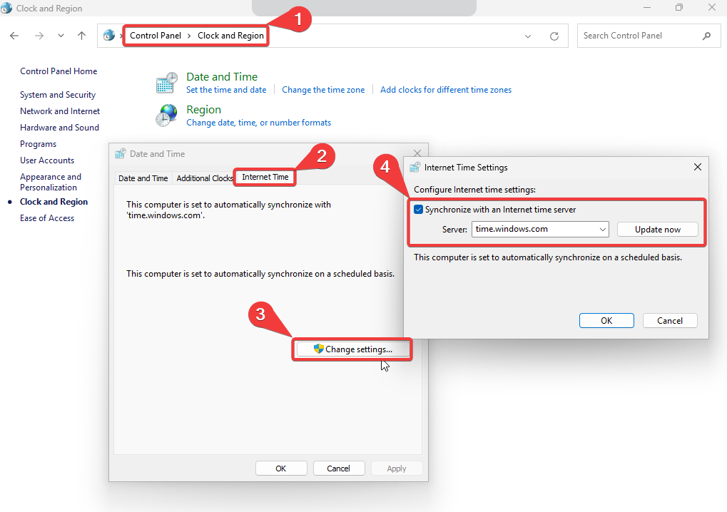

It is a good idea to keep system clock synchronized to a time server. To do so, use the utilities your operating system offers.
For example, to synchronize the clock on Windows 10/11, go to the Control Panel and select Date and Time section. In the "Date and Time" window that will open, switch to the "Internet Time" tab, click on the "Change Settings" button, check the "Synchronize with an Internet time server" box and use the dropdown to select the server to synchronize with. Click "OK" to save the changes.

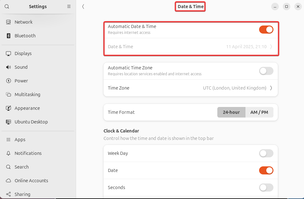

To synchronize the clock on a typical Ubuntu installation with graphical user interface, use your preferred method to open the "Date & Time" window and turn on the "Automatic Date & Time" switch located at the very top of the page.

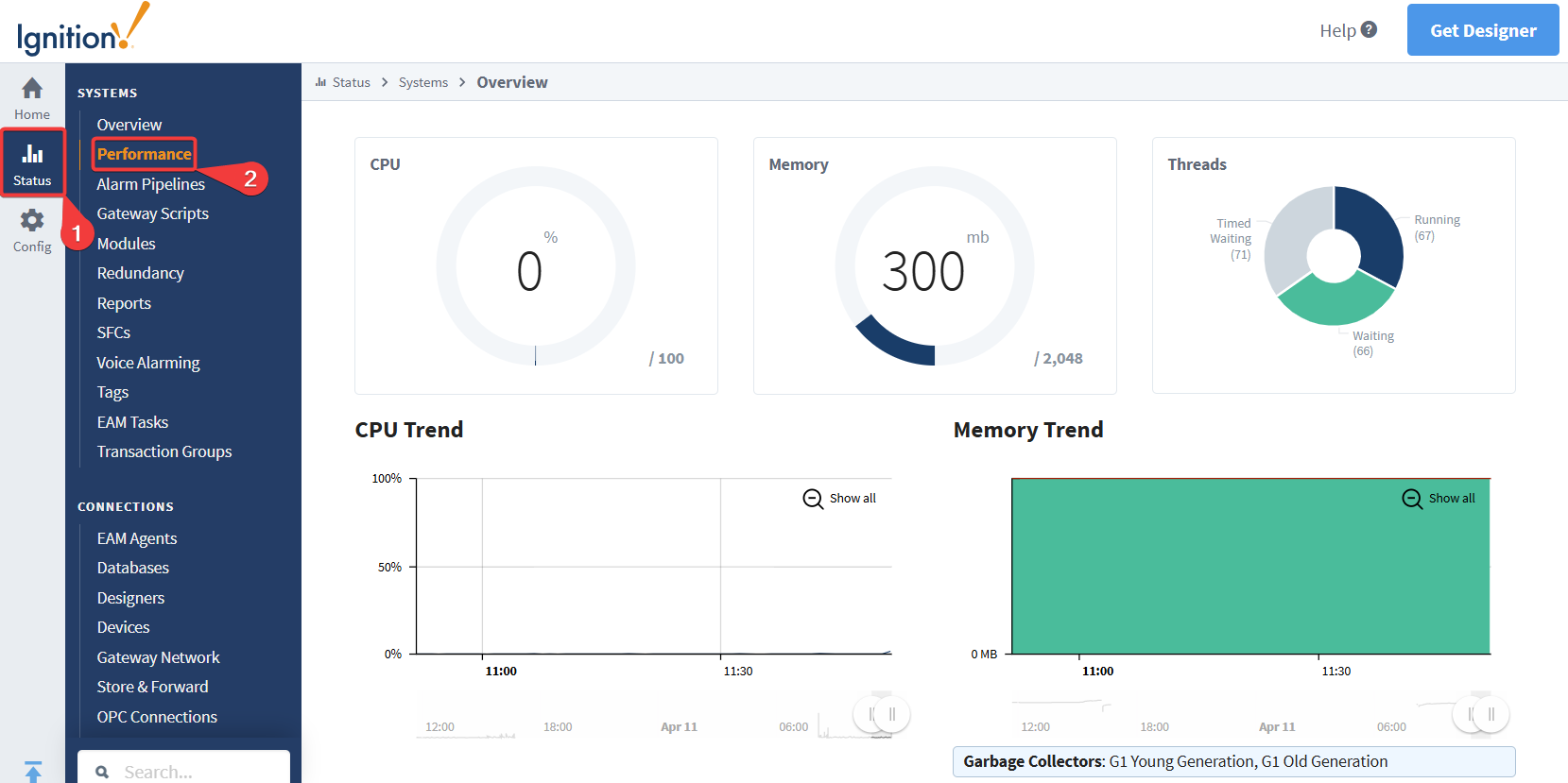

Check the CPU / Memory usage as reported by the Gateway’s Status / Overview page for Ignition 7.9 and higher.
Check the CPU / Memory usage as reported by the Gateway’s Configure / System / Status page for Ignition 7.7 and earlier.
If you see that the memory usage reported is chronically high (the ratio reported on the "Memory used/max" line is high, like in the image above), the Gateway may need more memory allocated to it.

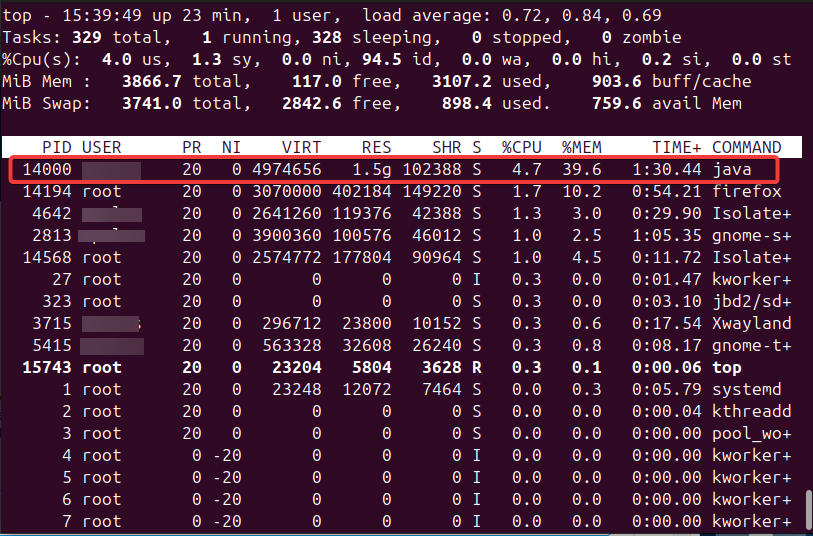

For headless Linux installations, you can enter the top command in the terminal and search for process labeled java.
If the memory usage reported by the operating system is high, the system does not have enough RAM to run all of the processes it is running. An Ignition Gateway on such system will almost certainly experience clock drift, and time-sensitive tasks are most likely not executing on time. To correct this issue, either remove additional applications consuming significant amounts of memory, or install more RAM. If the maximum Java heap size for Ignition is set to a very high value, it may also be useful to re-evaluate the need for such large heap size. This is the case where more is not always better, especially if the "used" value reported in the Gateway’s performance page never comes close to the "max" value.
