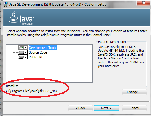

1) Install the Java Development Kit on the Ignition server
The Java Development Kit contains some tools you will need later. You can download the latest JDK here: http://www.oracle.com/technetwork/java/javase/downloads/jdk8-downloads-2133151.html
This guide uses JDK version 8 update 45. Note that you can have multiple versions of Java Standard Edition and the JDK installed on the same computer simultaneously You do not need to uninstall any other versions of Java.
Before downloading, you will need to agree to the Oracle Binary Code License Agreement for Java SE. Next, select the installer that matches the bit architecture of your gateway; e.g., if you have a 64-bit version of Ignition running on Windows then you will need the Windows x64 installer
If you are uncertain as to what version of Ignition you have installed, you can check the Status tab on the Gateway Webpage
Next run the installer. Follow the prompts to finish the installation process. Take note of the directory where the JDK is installed.

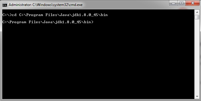

2) Open a command prompt
You will need to open a command terminal as the administrator for the next several steps. Navigate to the directory where the JDK was installed. The exact directory will be different depending on which version you installed. The command should look similar to the following: cd C:\Program Files\Java\jdk1.8.0_45\bin

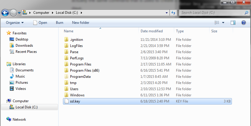

If you check the root directory of the C drive you'll find the newly created keystore:

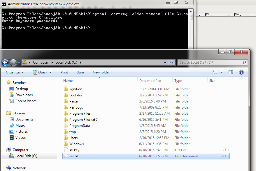

4) Generate a Certificate Signing Request
Type the following into the command prompt:
keytool -certreq -alias tomcat -file C:\csr.txt -keystore C:\ssl.key
This will create a Certificate Signing Request named "csr.txt" at the root directory on the C drive. It will use the keystore given the alias "tomcat" which is located at the root directory on the C drive.

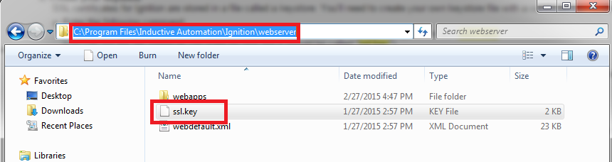

7) Replace Ignition's default keystore
Next you need to replace the default keystore that ships with Ignition. The default location for this file for is \Inductive Automation\Ignition\webserver\ssl.key
Make a backup of the default keystore in case you need to revert back. Once you have made a backup replace the default keystore with your keystore.
You will then need to restart the Ignition Gateway.
