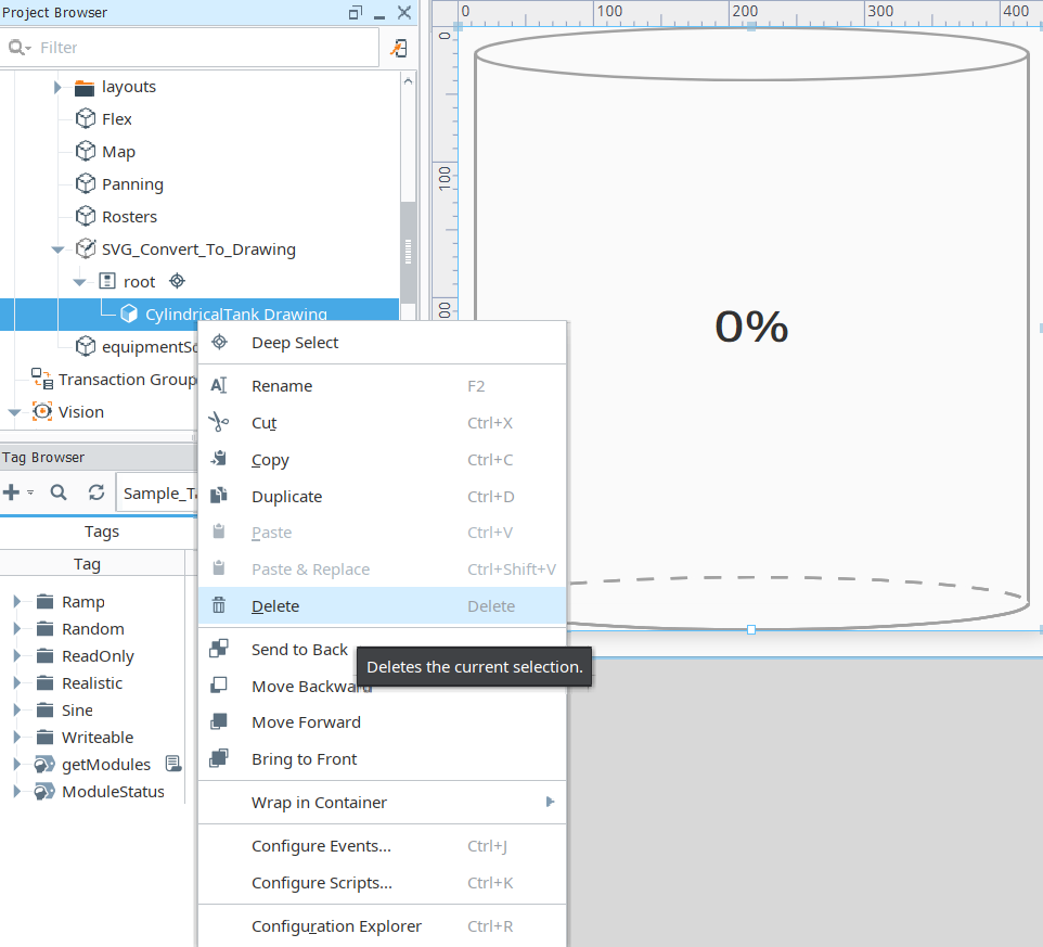

- Open the specific view in your Designer.
- Right-Click the specific SVG in the Project Browser.
- Select Delete.
- Once they are removed, locate the original SVG files and re-apply them to your projects. This should prevent Perspective views from running into similar behaviors on future updates.
