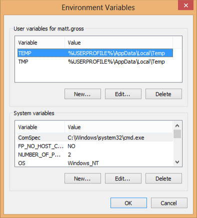

Open the Environment Variables window. Open File Explorer (Start Key + E). Right click on "My Computer" and select "Properties". Click "Advanced system settings". Click on the "Environment Variables" button in the
"Advanced" tab.
Find the Path variable in System Variables and click "Edit...".
- Now you need to add the path to your Java version that your existing application uses. You need to make sure it points to the bin folder for your Java version. It should look something like:
C:\Program Files\Java\jre1.6.0_01\bin
Make sure to separate the path locations with a semi-colon (;).
**NOTE** : The windows installer's for Java puts java.exe in your System32 folder so that you can run Java without setting environment variables. When adding "C:\Path\to\your\Java\version\bin" to your PATH make sure that it appears before C:\Windows\System32. Also make sure a different path to Java doesn't appear before your addition.
- Once you have added the correct version to the Windows PATH, type "java -version" in the Command Prompt to verify.

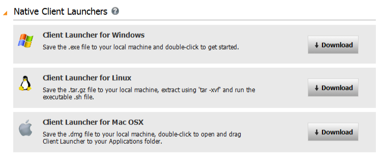

Ignition will try to use the correct version of Java automatically using the native client launcher. You don't want to use Java Web Start since you may have to change a few settings to get it to work. To use the native client launcher simply follow the steps below:
- Open the Ignition Gateway home page in your web browser (http://IPADDRESS:8088)
Download and run the Windows client launcher.

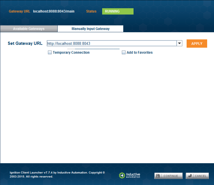

Enter in your Ignition Gateway URL on the "Manually Input Gateway" tab and press Apply. Then press "Continue" at the bottom.
- Launch your project and it will find the correct version of Java for you.
