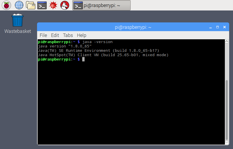

Type
java -versionand press Enter.
If you have Oracle Java 8 installed, your output will look similar to this:
Make sure the output contains "Java(TM) SE" and the version / build number starts with "1.8"
If you do not have Oracle Java installed, you will need to install it. Please follow the instructions from Oracle on how to install Oracle Java 8 JRE on Linux platforms.

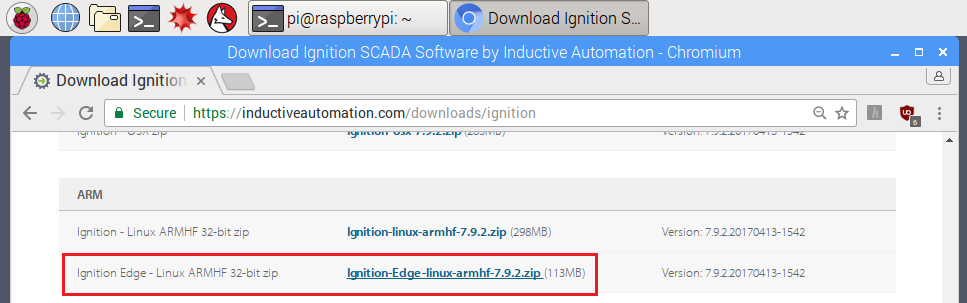

To download Ignition Edge Linux ARMF installer:
- Go to the Ignition downloads page.
- Scroll down to the "ARM" section and locate Ignition Edge - Linux ARMHF 32-bit zip installer.
- Download the Linux ARMHF 32-bit zip installer.

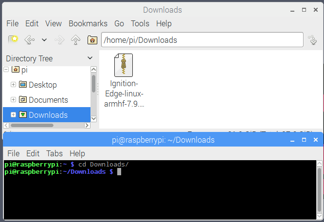

Change into the directory to which you downloaded the installer, for example:
cd Downloads -

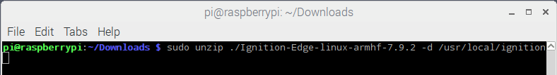

Extract the installer archive placing it into the /usr/local/ignition directory:
sudo unzip ./Ignition-Linux-armhf-7.9.2 -d /usr/local/ignitionMake sure to use the correct file name and location of your installer.

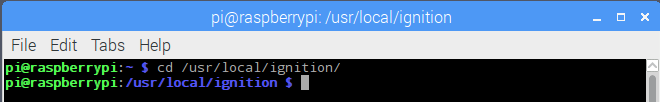

Step 3: Change into the Ignition installation directory
Change into the directory where you extracted the archive to:cd /usr/local/ignition
The next few steps will be performed from the /usr/local/ignition directory.

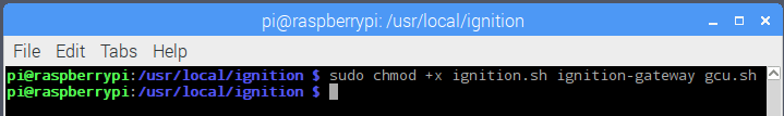

Step 4: Make files executable
Change file permissions on the ignition.sh, ignition-gateway, and gcu.sh files to make them executable:sudo chmod +x ignition.sh ignition-gateway gcu.sh

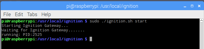

Step 5: Start Ignition Edge
From the /usr/local/ignition directory, run:sudo ./ignition.sh start
If Ignition started correctly, you should see the process ID output in the terminal:

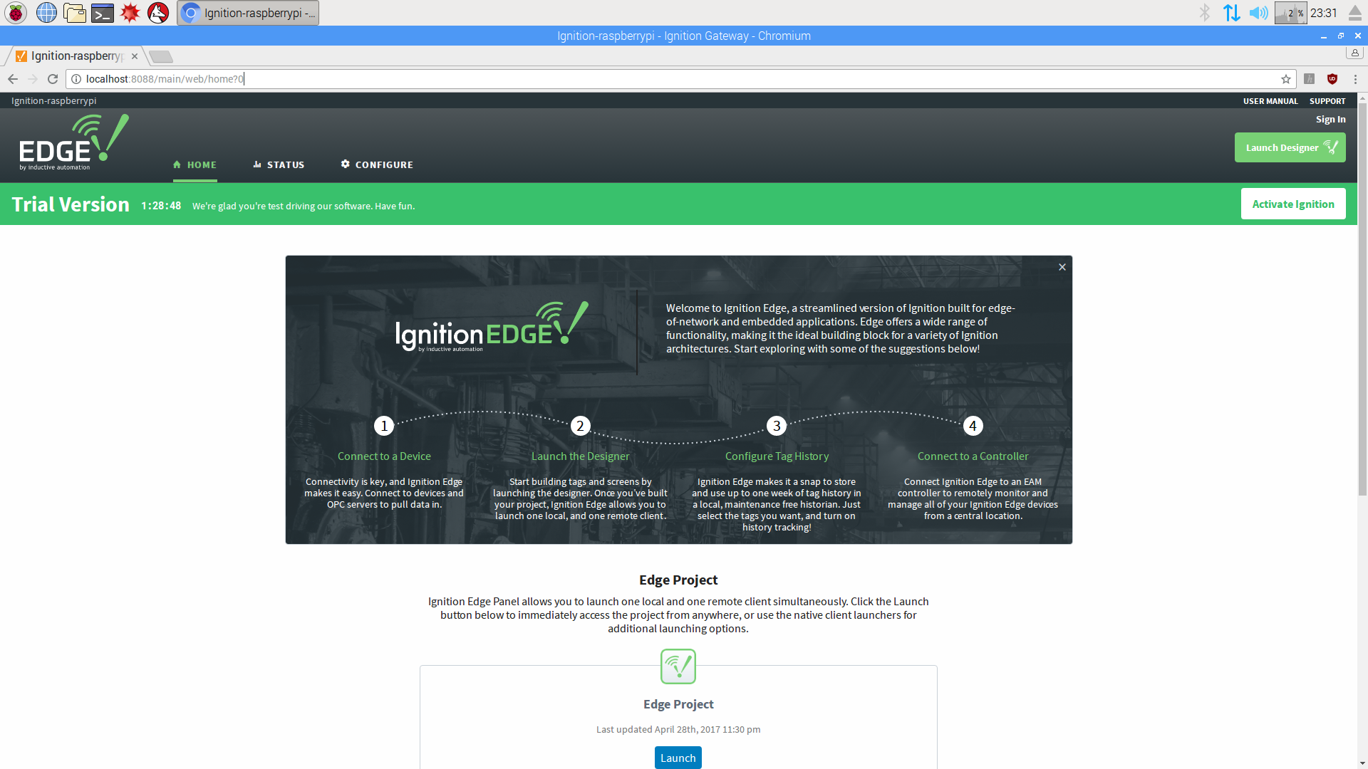

Step 6: Open the Gateway's web page
You can now navigate to the Gateway Web page. Open the Web browser and type the Gateway's address (http://localhost:8088) in the browser's address bar. You should see your Edge Gateway home page:
Congratulations! You have successfully installed and started Ignition Edge on Raspberry Pi!

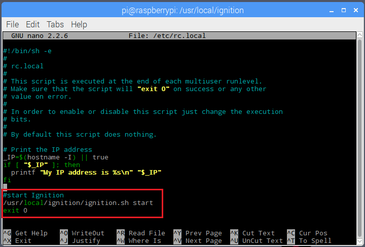

If you want to make the Edge Gateway start automatically on boot, follow these steps:
Run the following in the terminal to open the /etc/rc.local file in a text editor:
sudo nano /etc/rc.local -
Right before exit 0, add the following:
/usr/local/bin/ignition/ignition.sh start -
Exit the file saving the changes.
Use
Ctrl-Xto close the file. Choose to save changes when prompted.
Now your Edge Gateway will start automatically if you reboot your Raspberry Pi

rc.local doesn't exist anymore.
I created one with 755 and owned by root but still gateway did not start automatically after reboot. Any idea?
Also, do you have an article on installing the designer on pi?
