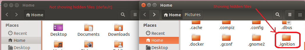

Note: on Linux-based operating systems (e.g. Ubuntu), and on Mac OS X systems, file and folder names starting with a
.are hidden by default, which means that initially you may not see .ignition folder under in the user directory.To show the hidden files and folders, including .ignition, you can:
- Use a keyboard shortcut or an appropriate menu item to make hidden files and folders visible.
For example, on recent version of Ubuntu pressCtrl-H, or use the "Show Hidden Files" option under the View menu. The shortcuts and menu options may differ depending on the operating system / distribution / desktop environment; check your operating system documentation for correct options.
On a Mac OS X, the shortcut to show hidden files is⌘-Shift-.

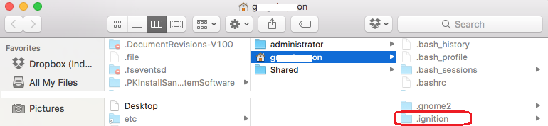

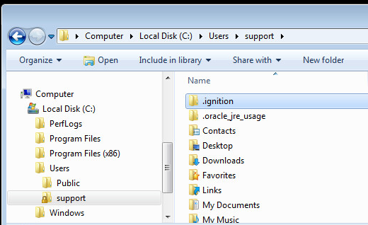

The .ignition folder contains cached Client resources, so that they can be reused on subsequent Client launches, helping to minimize download times. However, there may be times when this Client cache needs to be cleared so the next time the Client is launched, a fresh copy of all resources is downloaded.
To clear Client cache:
- Close any Clients and Designers running on the computer you are clearing .ignition cache on
- Delete the whole .ignition folder.
Next time you launch a Client or the Designer, a new copy of .ignition folder will be created in your user directory.

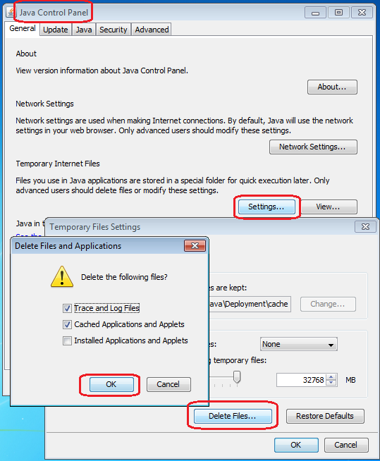

To open Java Control panel on a Linux distribution (e.g. Ubuntu), open the terminal and type
javaws -jcontrol
- Click "Settings" on the Temporary Internet Files section on the General tab
- Click "Delete Files" button on the "Temporary Files Settings" window that will open.
- Click "OK" on the "Delete Files and Applications" popup.
- You are done. Click "OK" to close the "Temporary Files Settings" window; click "OK" to close the Java Control Panel window

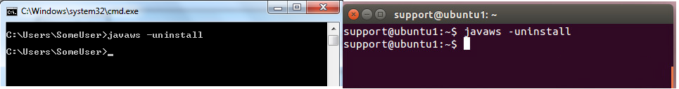

Clear Java cache from the command line
You can also use the command line or terminal to clear Java WebStart cache using the javaws -uninstall command:

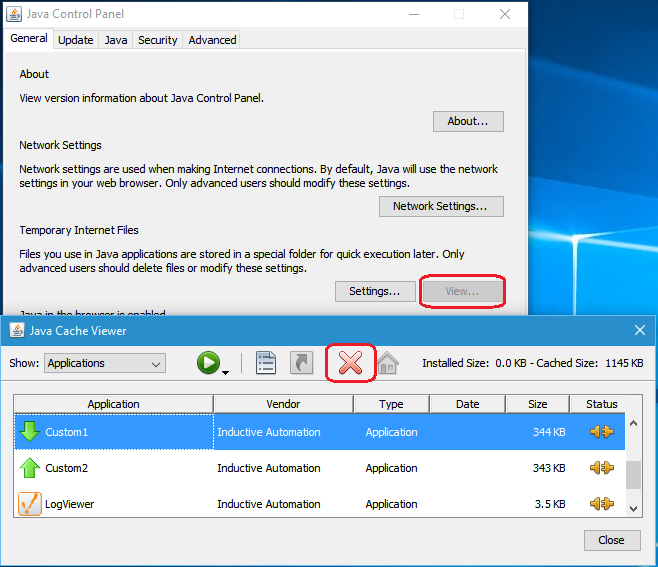

Clear Java cache for selected applications only
Using Java Control Panel also allows you to select which applications to clear Java cache for. This option can be especially useful if, for example, you are having issues with just one specific project, or if you have other, non-Ignition, Java applications which you do not want to affect.
To select which application to clear the cache for, use the "View" button on the Java Control Pane's "General" tab to open Java Cache Viewer. Select the applications you want to clear Java cache for and click the red X button to delete them.
