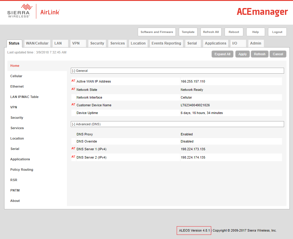

2. Update the firmware
Check if the your AirLink’s firmware is up-to-date.
Check the firmware version of your AirlLink RV50. You can see the ALEOS version shown at the very bottom of the page:
Alternatively, you can check the firmware version by clicking the “Software and Firmware" button in the top horizontal menu, or on the Status / About page of the ACE Manager (see the “ALEOS Software Version” property).

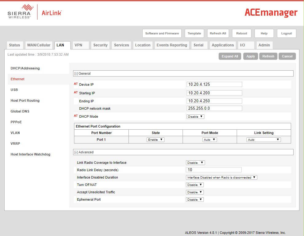

LAN > Ethernet settings
Go to the LAN tab, Ethernet option, and change the following:
- Device IP: your IP address
- Starting IP: your IP address + 1 on the last octet.
The last octet must be set to a number greater than what the Device IP is set to. - Ending IP: your IP address + X on the last octet.
If DHCP Server Mode is disabled, setting this should not matter; however, set it to the Device IP or higher. - DHCP network mask: 255.255.0.0 or 255.255.255.0 depending on your network.
- DHCP Server Mode: disable
Airlink RV50 has a built-in DHCP Server. This must be disabled. If it is not, it may cause network issues, creating conflicts on existing IP addresses already assigned.
The following is a screenshot example of the default LAN settings Inductive Automation is using. You should adjust these as appropriate to you network.

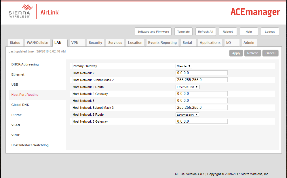

LAN > Host Port Routing
After the LAN / Ethernet setup is completed, proceed to the Host Port Routing section under the LAN Tab.
The router must be set to NOT act as the gateway on the network.
- Primary Gateway: Disabled
Failure to make the above setting may cause devices on the network to cease functioning. - Host network subnet mask 2: 255.255.255.0
- Host network subnet mask 3: 255.255.255.0

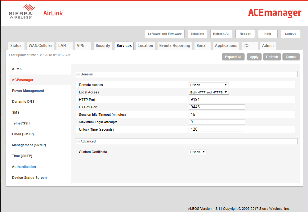

4. Disable ACEManager “Over-The-Air”
By default the ACEmanager can be accessed “over-the-air”. The configuration recommended by Inductive Automation suggests this should be disabled for added security in order to prevent external access to the device via the cellular network.
Services > ACEmanager
Go to the Services tab, choose the “ACEmanager” option, and set the Remote Access property to “Disabled”

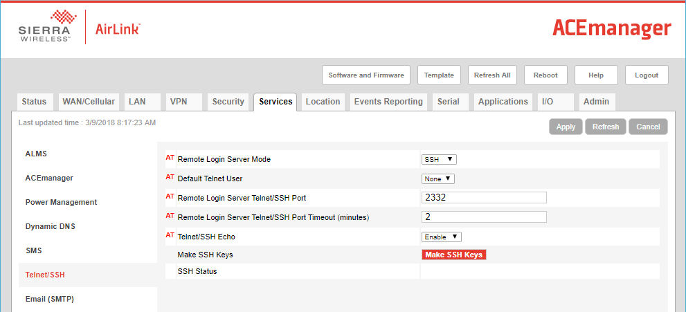

5. Configure SSH Interface
The configuration recommended by Inductive Automation suggests SSH in preference to Telnet.
To SSH into the router from systems that do not have built-in SSH functionality (for example, from Windows systems), use PuTTY or some other SSH Client. See Ethernet section for IP and login credentials.
Services > Telnet / SSH
Make the following changes in the Telnet/SSH section of the Services tab:
- Remote Login Server Mode: SSH
- Default Telnet User: None

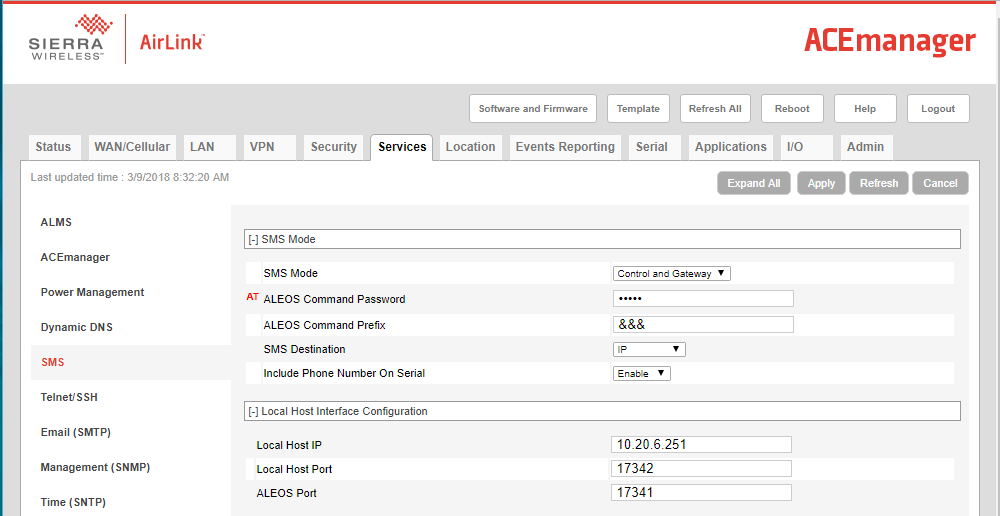

6. Configure SMS settings
In order to send SMS, it must be enabled.
Services > SMS
Go to the Services tab, SMS section and set the following:
- SMS Mode: Control and Gateway
- ALEOS Command Password: 12345
- Local Host IP: IP address of the Ignition Server.
- Local Host Port: 17342
- ALEOS Port: 17341

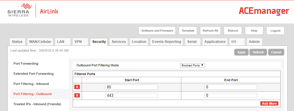

7. Configure Port Filtering and Outbound Ports
Port filtering is used to prevent outbound HTTP and HTTPS traffic over the air from the Airlink RV50.
Security > Port Filtering - Outbound
Go to the Security tab, Port Filtering - Outbound section, and set the following:
- Outbound Port Filtering Mode: Blocked
- Ports Filtered Ports:
- Start Port 80 and End Port 0
- Start Port 443 and End Port 0

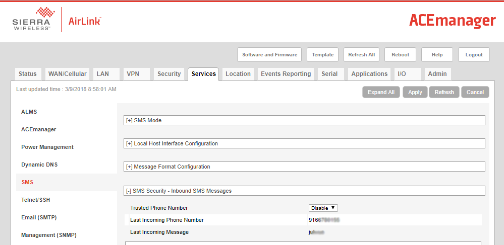

Test Sending & Receiving SMS Messages
Test sending SMS messages
Login to the Airlink RV50 via SSH and use the following basic command to send a test message:
at*smsm2m="1XXXXXXXXXX This is SMS test message."Test receiving SMS messages
To see if the Airlink RV50 is receiving text messages, send one to it. Then, go to the ACEmanager, switch to the Services tab, SMS section, and check the Last Incoming Phone Number and Last Incoming Message field. You should see the sender’s number and the message sent. Press Refresh if you do not see them immediately.
