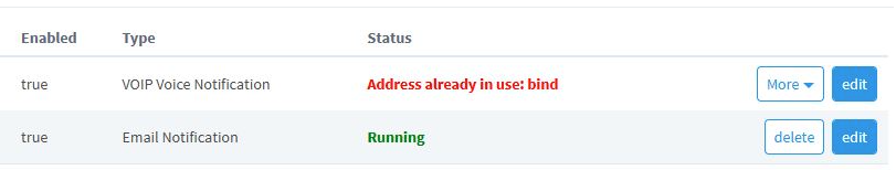

8.1.40 included an issue that caused Voice Notification profiles to stop functioning after a Gateway restart. This issue only applies to Gateways not utilizing redundancy. If your redundancy Mode is set to Independent, your Voice Notification profile will be impacted.
Details
While affected, alarm notifications will not be sent via Voice Notification profiles. Impacted systems will display a status of “Address already in use: bind”, as shown below.
In addition, the following message may appear in log files:
Error initializing user agent. Voice notification system will not be available. alarm-notification-profile=XXXXX
java.net.BindException: Address already in use: bind

Workaround
Voice Notification profiles can temporarily be made functional again by setting the redundancy Mode setting to Master and restarting the Gateway.
In cases where the Gateway cannot be restarted, Voice Notification profiles can temporarily be made functional again by editing the profile to change the SIP Port, then saving. This will make the Notification profile functional again, but only until the Gateway is restarted. Note that there may be firewall implications as part of changing the SIP Port.
