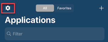

For IOS
You can obtain the logs in the Perspective app for IOS by following these steps:
- Open Ignition Perspective app.
- On the top left corner, tap on the settings icon.
- Tap on View Logs.
- You’ll be asked how you want to save or view the logs.
- You can email the log to yourself.
- After saving, you can open the log with a text editor (like Notepad++).

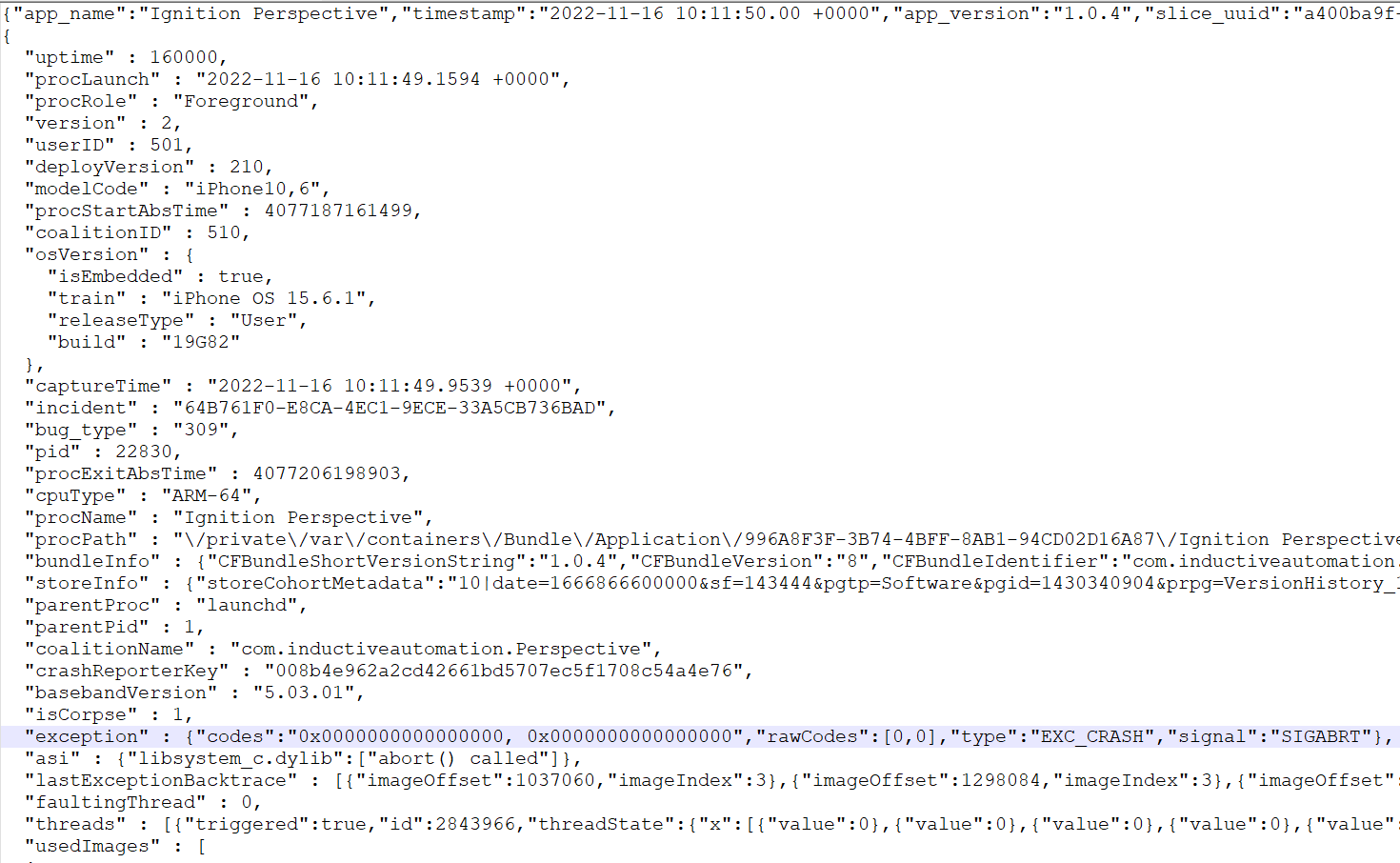

How to Obtain Crash Logs from iPhone and Android
Crash logs from an iPhone:
- Open Settings.
- Tap Privacy & Security>Analytics & Improvements.
- Tap Analytics Data.
- Locate the log for the app that crashed. The filename will use this format: <AppName>_<DateTime>_<DeviceName>. So search for any reference to Perspective or Ignition.
- Tap the crash log to open it.

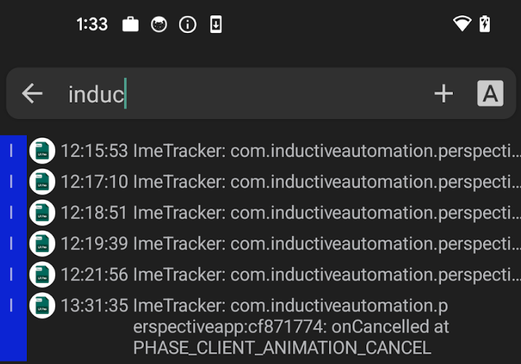

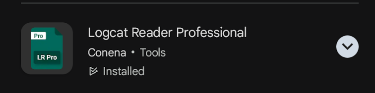

Crash logs for an Android:
- Open up the Play Store.
- Search up Logcat Reader.
- Install Logcat Reader Professional.
- Once installed, open up the app.
- Search for inductiveautomation or perspective.
- Tap on the log to view the messages.
The following is an example of a crash log.
