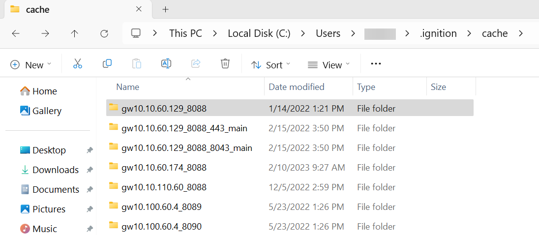

Ignition 8.1.12 introduced EDT blockage detection for the Designer and Vision Clients where automatic thread dumps will be generated. From within your client machine, the Ignition cache folder contains caches for all Gateways you've connected to. You will find this folder under your user directory. For Windows machines, the file path will look something like:
C:\Users\{yourUserName}\.ignition\cache
Once inside this folder, you can expect to find a list of separate folders where each correspond to a different Ignition Gateway that has served you a client session:
The folder's can be distinguished by the following structure:
gw{Gaterway Hostname}_{Gateway Port Number}
Refer to the structure above to locate the Gateway that corresponds with the client you are troubleshooting. Inside each folder, a series of subfolders labeled C0, C1, C2, etc. will be listed. In the event that the Designer or Vision Client performance is slow or is frozen, NonResponsiveEBT thread dumps may have automatically been sent to one of those subfolders. You will typically find them in the first folder C0 with the filename structure:
NonResponsiveEDT-yyyy-mm-dd-hhmmss
Keep note of the date and timestamp embedded on the filenames. In the event that multiple EDT blockages occur, this will ensure that you are inspecting the thread dump that corresponds with the time of the behavior.
