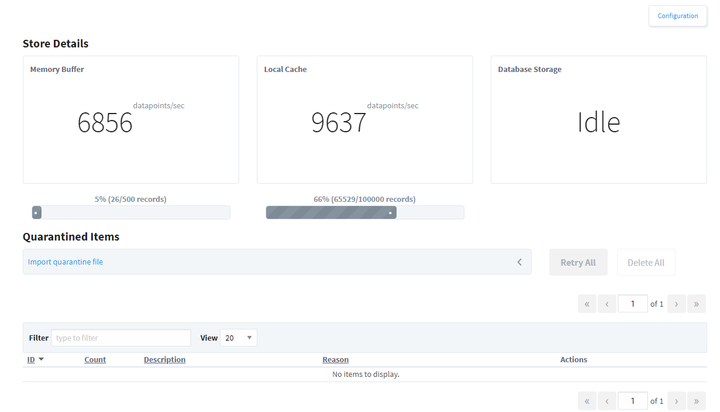

Disk Cache Exceeding 50,000 Records
The user manual states that it is not recommended to increase Max Records beyond 50,000. This is due to limitations with the use of HyperSQL (version 8.1 and prior) for temporary, internal storage. While it is not necessarily a hard requirement, it is important to keep in mind that a disk cache exceeding 50,000 can be more prone to performance degradation with read/write operations and even sometimes corruption of the records themselves. You may notice this kind of behavior when viewing Idle behavior with writes to you database on your Store and Forward profile's overview page:
In the example above, Max Records was set to 100,000 where temporary record storage was slowly increasing. This resulted in the Local Cache eventually reaching it's limit and was forced to drop older records. However, performance was allowed to resume normal behavior only by first backing up the existing cache data of the Local Cache and then reducing Max Records back down to the default limit (25,000).
In order to both keep up with current data and forwarding the backed up cache data, it may be necessary to backfill the cache data with a secondary Store and Forward engine. This will allow the primary Store and Forward engine to keep up with all current data forwarding and appropriately continue storing.
