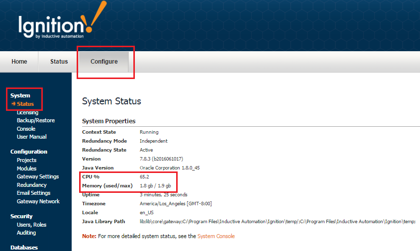

Make sure your Ignition Gateway is allocated sufficient memory resources
Check the CPU / Memory usage as reported by the Gateway’s Status / Overview page for Ignition 7.9 and higher.
Check the CPU / Memory usage as reported by the Gateway’s Configure / System / Status page for Ignition 7.7 and earlier.
If you see that the memory usage reported is chronically high (the ratio reported on the "Memory used/max" line is high, like in the image above), the Gateway may need more memory allocated to it.

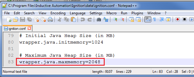

To allocate more memory to your Ignition Gateway, edit the wrapper.java.maxmemory property in the ignition.conf file:
On a typical Windows installation ignition.conf file is located in the C:\Program Files\Inductive Automation\Ignition\data\ directory. On a typical Linux installation, it is located in the /etc/ignition/ directory.
The value for the wrapper.java.maxmemory property is specified in megabytes. By default it is 2048 for a 64-bit installation, and 1024 for a 32-bit installation. Change the value and save the changes. A Gateway restart will be required to load the new configuration.Warning: Be careful increasing the wrapper.java.maxmemory property value: make sure your operating system has enough free memory to accommodate this change, otherwise the Gateway will fail to start.

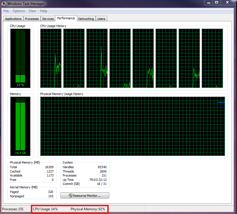

Check the total CPU and RAM usage as reported by the operating system (make sure you are checking it on the computer where Ignition is installed).
To check resource usage on a Windows operating system, use your preferred method to open the Task Manager. When the Task Manager window opens, switch to the "Performance" tab to see the system's CPU and Memory usage graphs.
On Windows 8 and higher, you are provided with individual subtabs to view various metrics for each.
On Windows 7 and earlier, you can also look at the bottom bar to see the percentage values.
In the image above, the Task Manager is reporting memory usage of over 90%. This system does not have enough RAM to run all of the processes it is running.

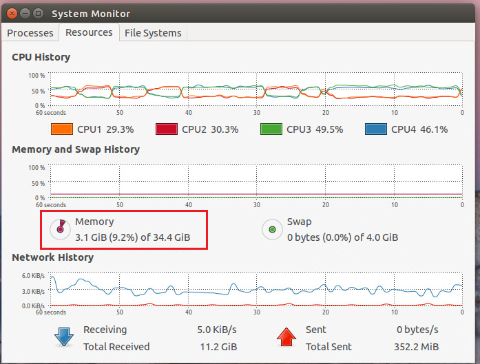

To check resource usage on a typical Ubuntu installation with a graphical user interface, use your preferred method to open the "System Monitor" window and switch to the Resources tab to see the system's CPU and Memory usage graphs. You can also look at the legend under each graph to see the percentage values.
In the image above, the System Monitor is reporting memory usage of under 10%. This system is not resource-starved.
