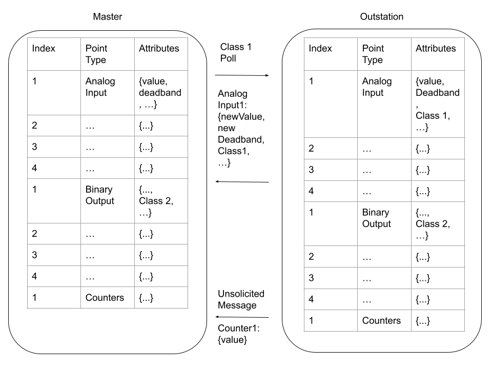

Outstations
DNP3 protocol either passes measured data from or control commands to the plant floor mechanisms by using multiple interconnected outstations. Outstations are considered processes at their core, but will typically be referred to as devices or systems that exist in a plant floor’s network. In order to establish a network of outstations, you need to acknowledge two major components:
- Master: A device in charge of administering control commands and receiving data from other devices.
- Outstation: A device responsible for transferring measured data to its master or control commands from its master.
Inside every outstation resides a database that stores various point data using indices as well as categorizing them into different types. Points are where static, measured values of a monitored plant floor process reside along with other attributes such as name, scale factor, event value, etc. A point’s type provides a way to distinguish different points that may contain similar characteristics. Example point types are:
- Binary Inputs
- Binary Outputs
- Analog Inputs
- Analog Outputs
- Counters
Outstations will update specific types and indices of various points based on changes being monitored on the plant floor. Master outstations will then update their databases with point data coming from outstations they are directly connected to using one of two ways:
- The master will pass specific function codes to an outstation requesting one or more points in its database be updated with any new point data.
- An outstation will pass unsolicited data to the master, regardless of any initial request.

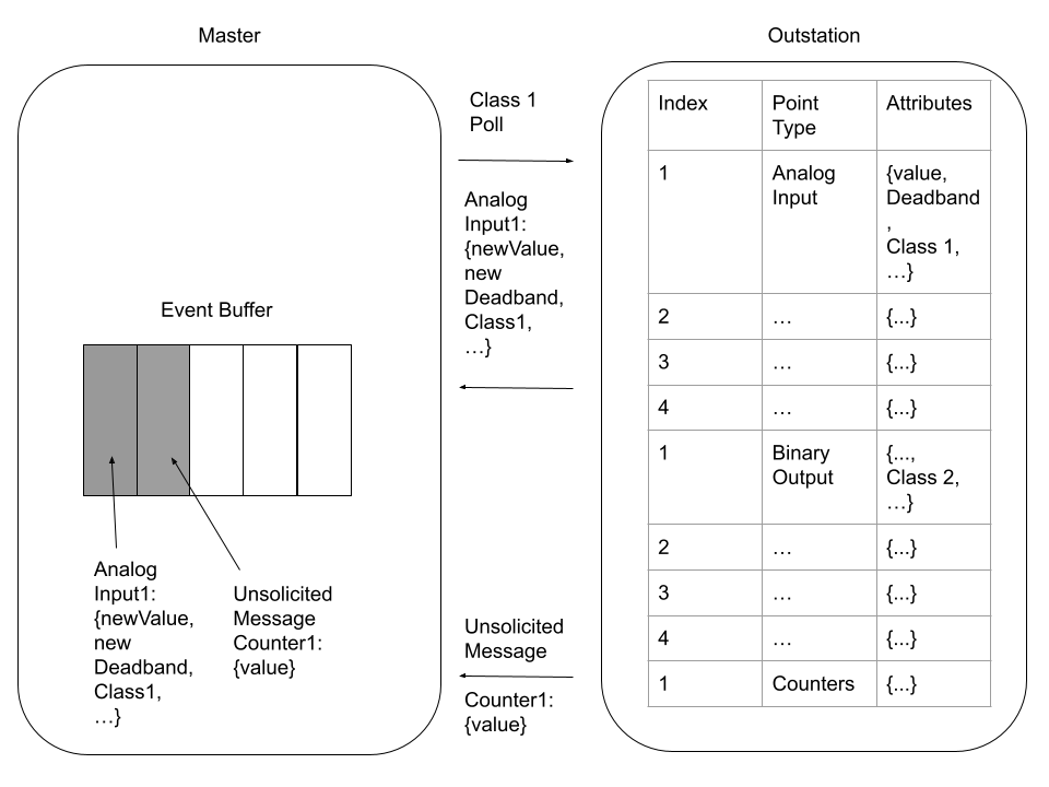

Event-Based Data Acquisition
DNP3 uses a method of data acquisition across outstations known as event-based reporting. If you refer to the outstation’s database of points, each and every point is organized by point type and index. Each point’s attributes stay up to date with the most recent values through triggered events in the device. Instead of following the more traditional (and probably more familiar) method of using a tag subscription to periodically poll for specific values available in a device, DNP3 event-based reporting will pass only data due to changes that occurred from a point’s source. The DNP3 processes that rely on events for data are known as Class Polling and Unsolicited messaging.
Class Polling
A point within an outstation’s database will contain one of three class event types in the form of a unique attribute. This attribute is expected to be defined by the DNP3 device programmer before any requests are made. These class attributes give points some level of priority classification in order of 1 (highest priority) to 3 (lowest priority). Prioritization of points may be needed in situations where data from high-priority marked events need to be processed sooner and/or more often than others.
Between the master and outstation, when it comes the time to activate event-based data acquisition between the two, the master is expected to define individual poll rates for the three classes, or at the very least a rate from one class (the rest can be 0) depending on what is configured for your points. The master is also expected to be able to handle multiple events through the use of a temporary buffer each time its class poll receives a new event since polling in this protocol expects a bundle of one or more events that occurred across different points.
Integrity Polling
When a master and outstation have established a connection for the first time, either device has restarted, or a long amount of time has passed and a monitor check is due, an integrity poll is performed. This is because integrity polls will request the synchronization of the entire master database with the outstation, which includes all class 1-3 event data and any static data that is also configured with class attributes. A fourth class type of class 0 exists which is considered the lowest in priority during this poll. This is because class 0 attributes are only applied to objects that return static data and not events. Due to the potentially large volume of data that will be sent to the master with this method, it’s best to use class polling when possible.
Unsolicited Messaging
Unsolicited messaging is another feature that expects the master to handle the buffering of events. Instead of waiting for the master to send a class poll request, outstations will send over an event to the master immediately after a change occurs, hence the name “unsolicited”. Instead of defining class polls, masters can be configured to accept these unsolicited messages from an outstation.
The Data-Link Layer
The connection between master and outstation requires a unique communication layer known as the Data-Link layer. In terms of the OSI networking model, we can define this structure as a lower-level application layer detail. During the scenario of an application request passed between master and outstation, the request itself requires unique addressing information and exception handlers to be attached before being transmitted through the physical layer of a given network. Both the master and outstation are expected to be configured with their own local source addresses as well as whitelisting addresses of request destinations for its established data-link layer.
Once outstation address information is appended to the request, we can expect the frame of the message to be sent as shown in the following diagram:
