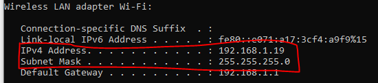

First, you will need some network information from the computer running Ignition. Running ipconfig in command prompt will give you the requisite information. In specific, you are looking for the subnet mask and the IPv4 address.
After supplying the IP address and subnet mask in their respective fields in the calculator, pressing calculate will generate the broadcast address among some other useful information. The network prefix is the number specified by the CIDR Notation, and can also be calculated by counting the number of leading ones in the binary subnet mask. The IP address for the remote device you are attempting to connect to should fall inside of the address range that is noted in the "Usable Host IP Range", meaning that it is on the same subnet that Ignition is broadcasting to.

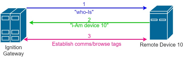

Scenario 1 (Broadcast and Broadcast):
In this scenario, the Ignition gateway and all remote devices reside on the same subnet. They all have access to the same broadcast channel and thus initialization can happen via broadcast messages.
1. Ignition's BACnet driver utilizes broadcast technology in order to initialize/connect to remote devices. This means that Ignition's local device will send a request out to the entire network looking for remote BACnet devices that exist on the network. On the network, this request for remote devices comes in the form of a "who-Is" request.
2. Devices on the network then make themselves known by responding in kind with an "i-Am device x" message sent to the same broadcast channel.
3. From there, Ignition will attempt to communicate with the device that has the ID specified in the remote device configuration. Note that the remote IP address in the configuration is not necessarily respected. Due to the nature of broadcasting, whichever remote device responds with an "i-AM device x" first - where x is the configured remote device ID - Ignition will attempt to make the connection to, regardless of its IP address.

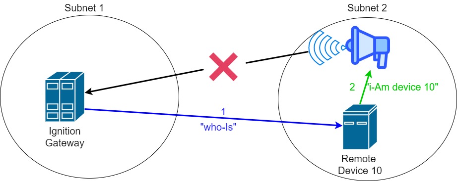

Scenario 3 (Unicast & Broadcast):
In this scenario, Ignition can successfully send a unicast message directly to the remote address. However, the remote device follows BACnet standards and responds with a broadcast "i-Am" to the subnet that it resides on. Since Ignition is on a different subnet, and broadcasts do not travel across subnets without a BBMD or BACnet router, Ignition never receives the "i-Am", causing initialization to fail.

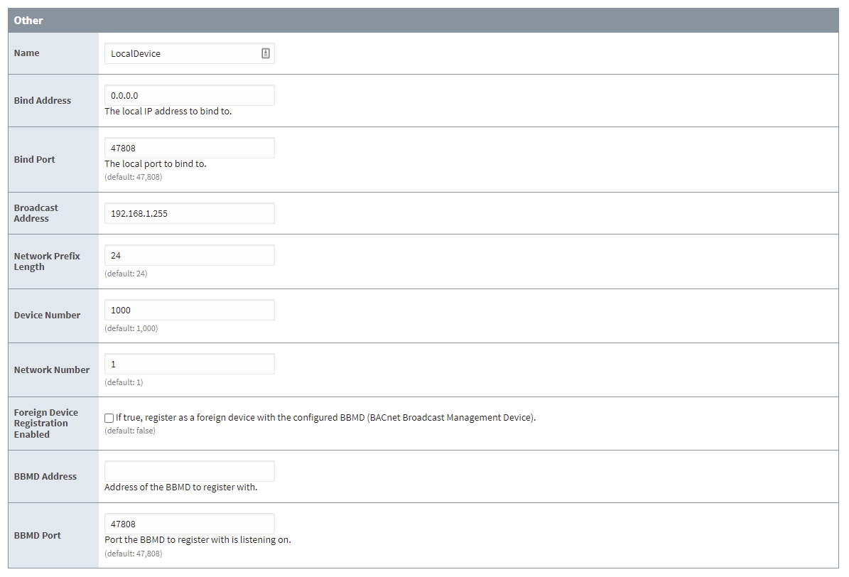

Local Device:
Bind address:
The bind address determines which local network interface the BACnet driver listens on. In most cases, use 0.0.0.0. This allows the driver to listen on all interfaces and reliably receive both unicast and broadcast BACnet traffic. When multiple network interface cards (NICs) are present, you can bind a local device to a specific IP address to isolate traffic to a single subnet.
Broadcast handling differs by operating system:
- Windows: Broadcast packets are typically delivered even when bound to a specific IP.
- Linux and macOS: Broadcast packets may not be delivered unless bound to 0.0.0.0, depending on OS behavior and the BACnet4j version included with the Gateway. Recent versions may bind to both the specific address and broadcast address automatically.
Because behavior varies by platform and version, 0.0.0.0 is the most reliable configuration when broadcast discovery is required.
Port:
47808 is the default BACnet/IP port (BAC0 in hexadecimal). Use one local device per subnet, or assign each device a unique port.
Each local device must use a unique IP and port combination. Configuring multiple local devices to bind to the same address and port is not supported.
When multiple devices share the same socket (for example, 0.0.0.0:47808), the operating system distributes incoming packets non-deterministically. Messages may be delivered to the wrong device or dropped entirely. Even on small systems, this can cause:
- missed responses
- retries and timeouts
- intermittent initialization failures
- inconsistent or lost data
Windows link-local address requirement
When using link-local IP addresses in the 169.254.0.0/16 range on Windows, BACnet traffic may not route correctly by default.
If either the local or remote device uses an address in this range, add the following JVM property to ignition.conf:
-Djava.net.preferIPv4Stack=trueAlternatively, use IP addresses outside of the 169.254.x.x range.
Broadcast address/Network prefix:
See the above section on Network Prefix/broadcast address. It is important that the broadcast address is for the subnet that the device you are trying to connect to is on. Ignition must also be able listen on this subnet. If Ignition has multiple NICs and is connecting to remote devices on separate NICs, multiple local devices will need to be created, each with unique ports and corresponding broadcast addresses.
Device number:
This is an arbitrary number that can be set to anything. The only stipulation is that it should be a unique ID in relation to all other device IDs on the BACnet network.
Network number:
This setting should be fine to leave as default. The only time this setting may need to be changed is if there is an existing BACnet network that is already using network number 1 on the network.
BBMD/Foreign Device registration:
If the BBMD you need to connect to is on a different subnet than Ignition, you will need to enable Foreign Device registration and specify the BBMD address. In this example, everything is on the same subnet, so no BBMD is required. It's also important to note that if registrations to multiple BBMDs are required, multiple local devices(with unique address/port combinations) will be needed to make those connections.

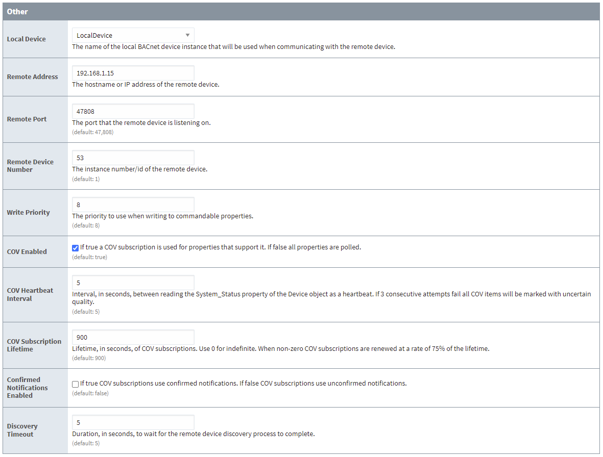

Remote Device:
Remote address/Port:
This is the address that Ignition will send a unicast "who-Is" message to. In many cases, this address is not necessarily respected, as Ignition will attempt to connect to the first device that responds with "i-Am device {Remote Device Number}" regardless of its IP address.
Remote Device Number:
This is the most important information, as Ignition will only attempt to connect to a device that has the matching Device ID. It is important to know that certain BACnet routers or BBMDs can sometimes shift device IDs when translating across subnets. Wireshark or a third-party BACnet explorer program is helpful here to browse for all device IDs that are present on the network to confirm the actual device ID that is being broadcasted.
A remote device may have a single IP address with many device IDs associated with it. In this case, Ignition must have a separate remote BACnet device configured for each device ID corresponding to that IP address.
COV:
Stands for Change of Value. These settings are not relevant for the initialization process, as they affect how Ignition polls the devices once a connection is made. If this is enabled, Ignition relies on the device to send updates when values change instead of periodically polling the device.
Discovery timeout:
This field was added in 8.1.4, and dictates how long, in seconds, before the initialization times out. This may need to be extended if connecting over a slow network or to a device with many tags.

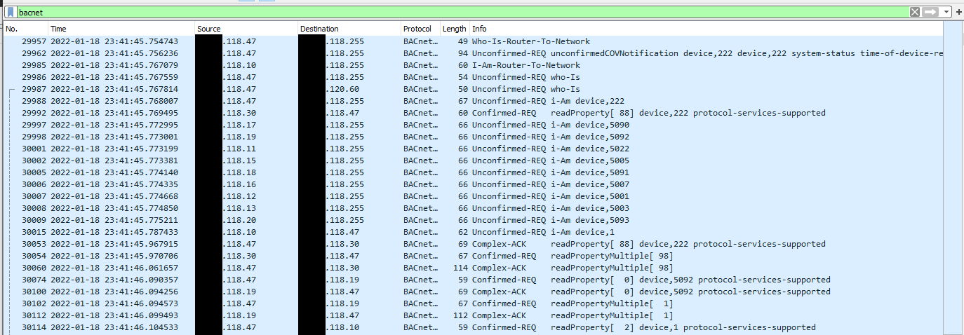

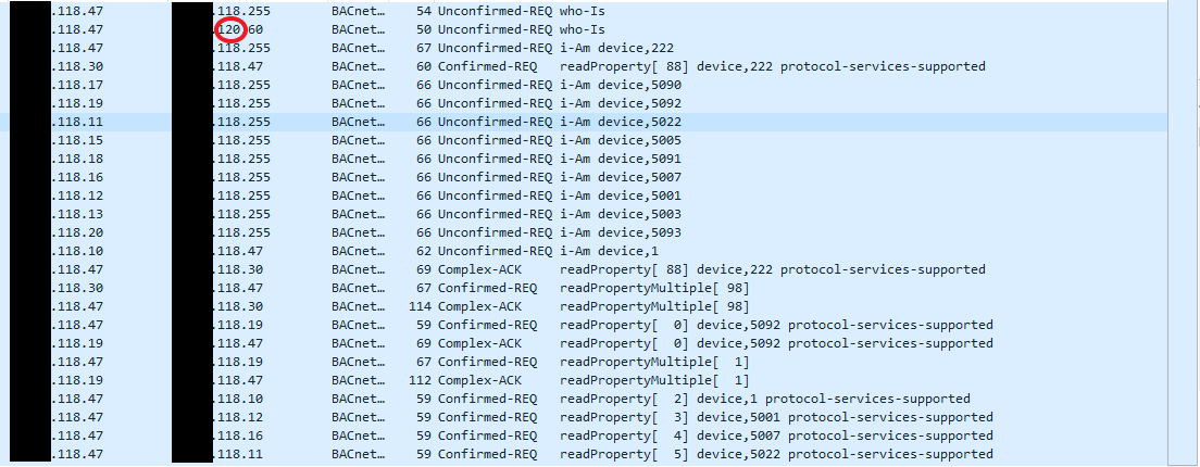

If Ignition is sending out "who-Is" messages and other devices are getting back with "i-Am" messages (can be confirmed with Wireshark), where the device IP address is correct, but the device ID does not match what is specified in the remote device configuration, then the Remote ID may not be what you think it is. YABE will be able to confirm what the remote ID should be, and that is what you will need to supply in the remote ID field for the remote device configuration.
No response/wrong response to Ignition's "who-Is":
Most often the cause of no response whatsoever is that the broadcast address is incorrect or Ignition is attempting to broadcast to devices that are on a separate subnet. YABE is a good tool to verify if the computer Ignition is running on can connect to any devices at all. As for solutions, you may need to add a NIC or BBMD/BACnet router in order to communicate with a different subnet.
Example:
In this example, we see Ignition broadcasting to it's own x.x.118.255 subnet broadcast address. We also see Ignition send out a unicast "who-Is" to the device that resides on the .120.x subnet. When receiving "i-Am" responses back, Ignition is able to see broadcasts on the .118.255 broadcast channel, but does not receive anything back from the .120 subnet. In this scenario, a BBMD/BACnet route would be necessary for Ignition to connect to a device that resides on the .120 subnet.
