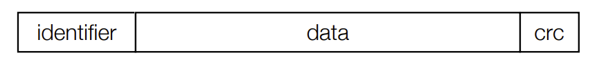

In order to distinguish between different adaptations of CIP when handling service requests, one of four unique identifier formats are prepended to the message’s frame for identification.
In the diagram above, the data section of the CIP message structure is responsible for containing the service codes as well as resulting outcomes. The term CRC is an acronym for Cyclic Redundancy Code which acts as the primary means of checking for possible corruption in the frame’s data after transmission. This corruption check works by first generating a CRC during a producer’s preparation to send a message frame out into its network. Once one or more consumers receive this message, they will check the CRC for malformations before unpacking any service codes.

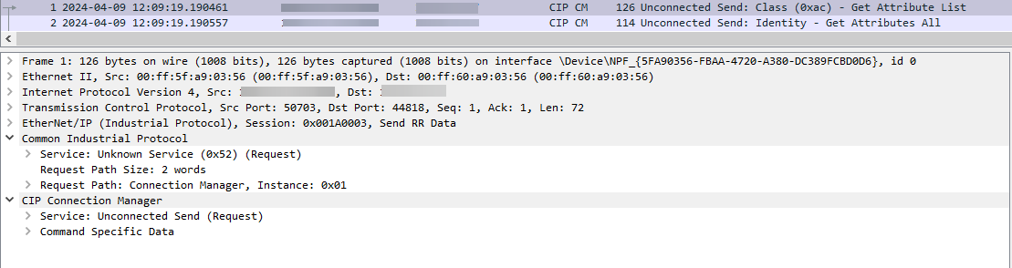

In this example, a v21+ CompactLogix device has already accepted a TCP connection with Ignition’s Logix driver. Ignition is now attempting to request from both the Identity object and Symbol object for general device information as well as any browsable tags programmed to the device. These packets come from messages sent by the CIP Communication Manager (CM) periodically for the duration of the device connection.
In the image above, the message stating Class (0xac) - Get Attribute List describes the Allen-Bradley driver (the client) requesting a set of attributes that will quickly notify Ignition if any changes occurred across any symbols/templates (the addresses pointing to a device’s tags). If any changes are detected in the device’s response, a re-browse occurs on Ignition’s side to reflect the changes stated by the device.

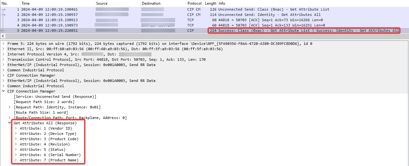

For this example, no changes were detected on the device. In the image above, the response of the service request Get Attributes All - 0xac provides attributes (Revision, Product Name, Status, etc.) from the device’s Identity object. This can be found under the capture’s expandable section: CIP Connection Manager.

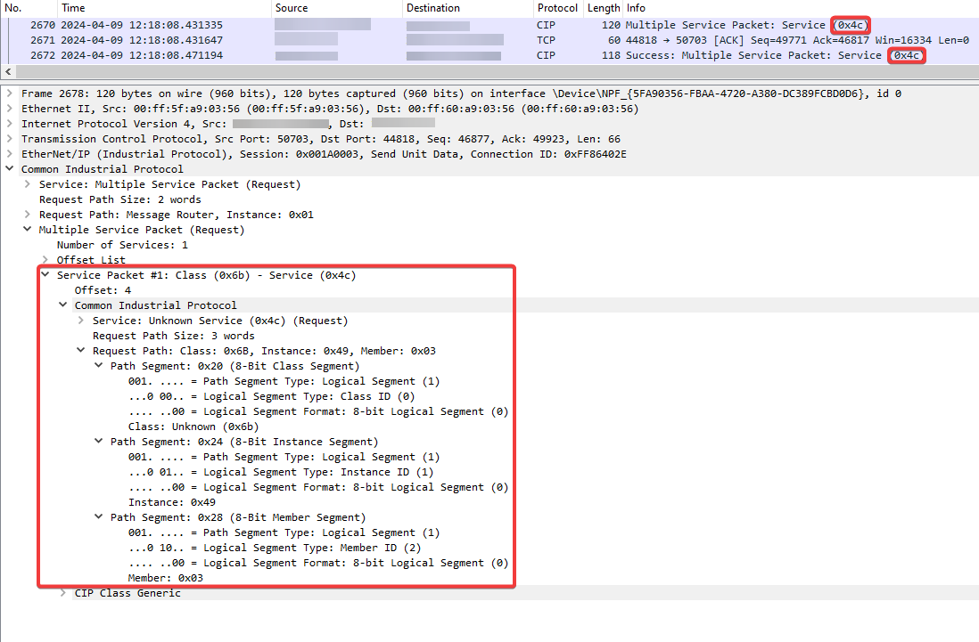

In this example, a v21+ CompactLogix device has already accepted a TCP connection with Ignition’s Logix driver. The capture is a result of subscribing to a random tag in the OPC Quick Client. These packets come from the Wiresharks’ exposed Common Industrial Protocol (CIP) packets and are expected to occur periodically for the duration of tag subscription.
In the image above, the message stating Multiple Service Packet - Service (0x4c) describes the Allen-Bradley driver requesting data from one or more tags in the device. When looking at the packet itself and expanding the Common Industrial Protocol section’s Multiple Service Packet (Request), you can locate the single tag request from the expandable section Service Packet #1: …. Then will you be able to observe specific symbol addressing described within the Request Path by checking the Instance and Member attributes.

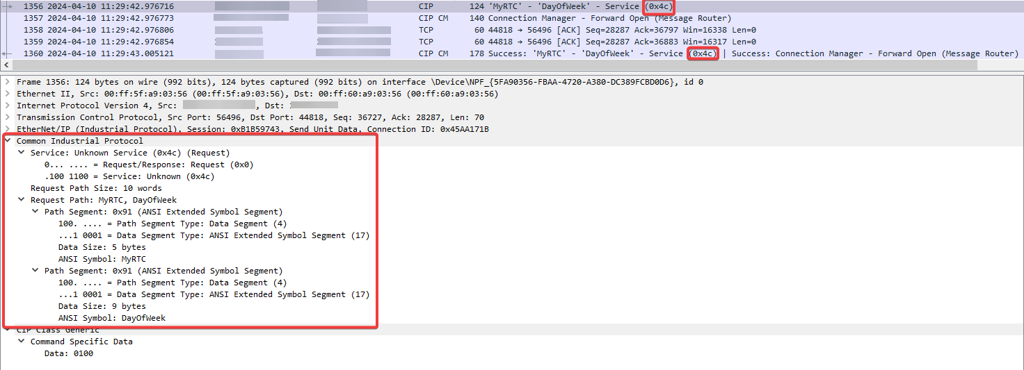

Multiple Service Packet Service (0x0a) can be described as an additional wrapper for CIP requests. It allows one or more requests, of potentially different types (read, write, etc.), to be bundled into a single request for efficiency. Allen-Bradley device connections that support this service are expected to contain the setting, CIP Connection Size, which basically allows users to control the maximum number of service requests that can be bundled into a single request.
Compared to the Logix and Legacy drivers that use the same symbolic addressing, the Micro800 driver does not support Multiple Service Packets. This is will result in some noticeable differences during a Wireshark capture:
On the image above, you can see a read service code (0x4c) is being called against the tag MyRTC. While this may appear as a simple read request, there are some key differences occurring in this capture example when compared to a Logix/Legacy driver device connection:
- The tag in the snapshot is a tag member defined within a structure. The driver is able to make a direct request to this tag using the address provided by a prior CSV import against the device connection. No OPC subscriptions have been created by any client (Ignition) during this test.
- This service request is being called in its own individual packet and not bundled (no Multiple Service) with other tag reads.
- If you compare the contents of the Request Path in the Common Industrial Protocol section of this Micro800 image with the Logix example, you will notice that the attributes Instance and Member have been replaced with the attribute ANSI Symbol.
- Instance/Member attributes allow Logix 5000 devices to take full advantage of Symbolic Addressing in Allen-Bradley devices since they can locate tags within complex structures using a minimal amount of characters (hexadecimal values). Addressing a tag in the device using ANSI Symbols can potentially require exceedingly long character strings, which is less efficient when passed into a data frame over Ethernet.

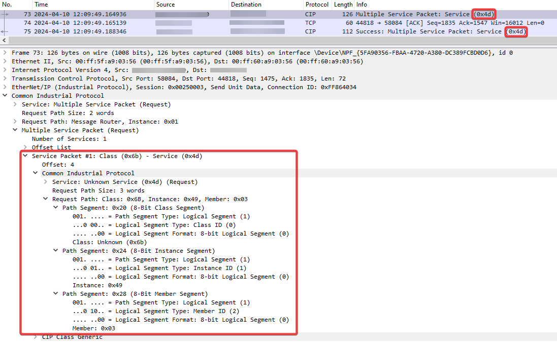

In this example, a v21+ CompactLogix device has already accepted a TCP connection with Ignition’s Logix driver. The capture is a result of writing to a random tag in the OPC Quick Client. These packets come from the Wireshark’s exposed Common Industrial Protocol (CIP) packets:
In the image above, the message stating Multiple Service Packet - Service (0x4d) describes the Allen-Bradley driver writing data to one or more tags in the device. When looking at the packet itself and expanding the Common Industrial Protocol section’s Multiple Service Packet (Request), you can locate the single tag request from the expandable section Service Packet #1: …. Then will you be able to observe specific symbolic addressing described within the Request Path by checking the Instance and Member attributes.
