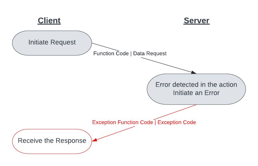

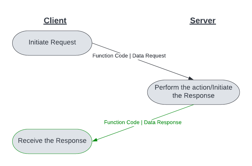

Modbus Transaction
During an error free transaction the server simply responds with the same function code requested by the client and the data response. If an error occurs, the server responds with the Exception Function code followed by a specific Exception code.
Request with an Expected Response:
Request with Exception Response:
